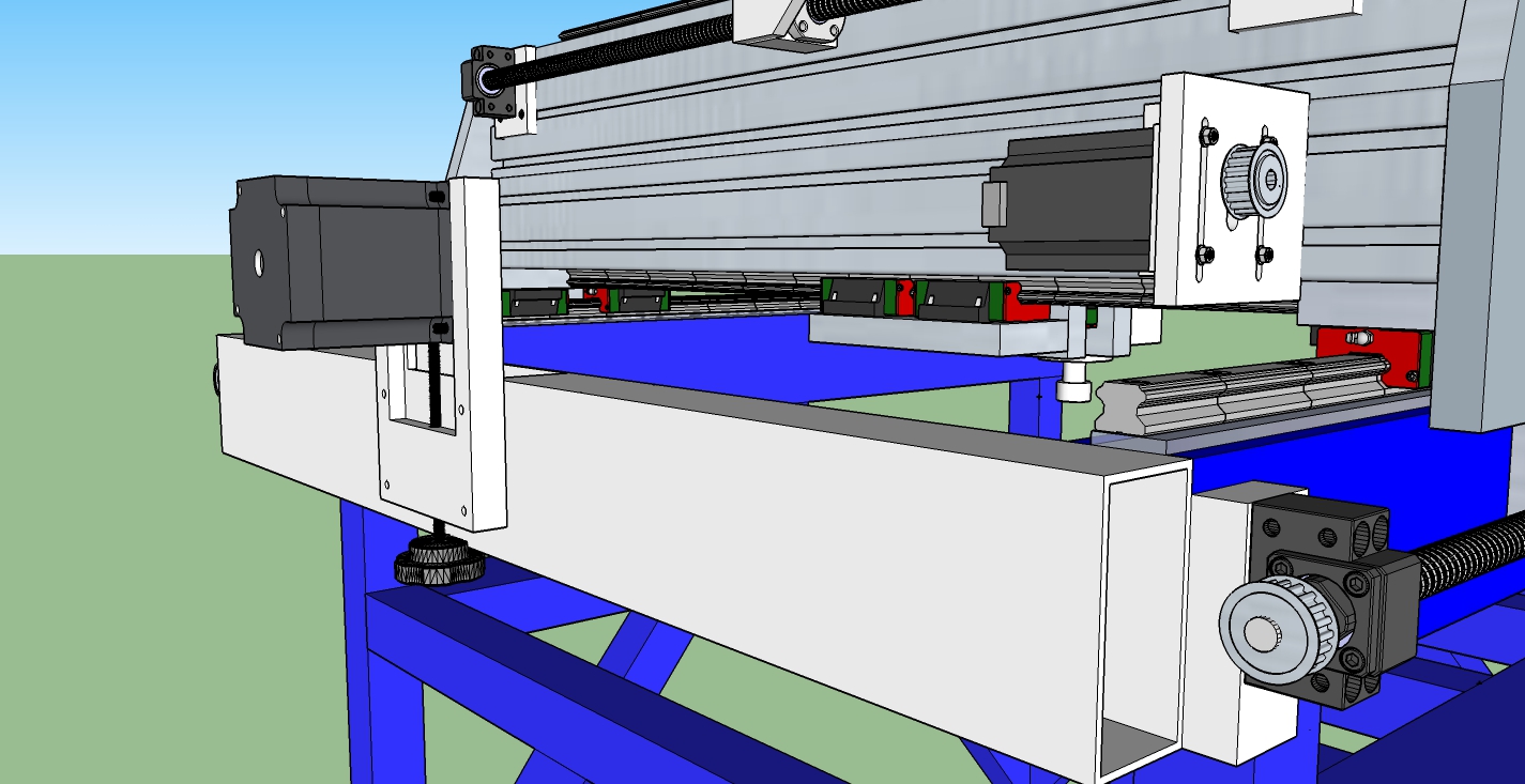

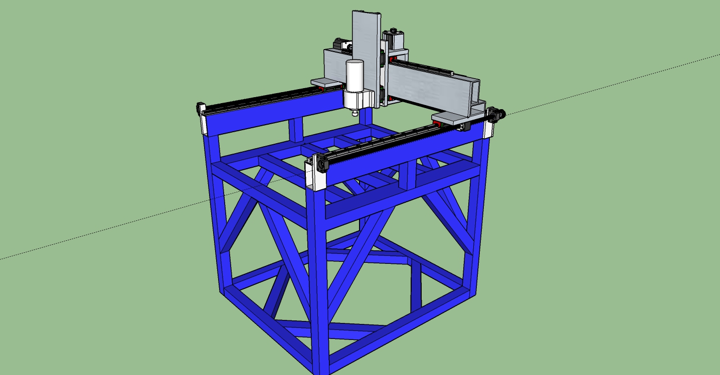

    Hi CNC Experts
    For some time now I have planned to build a 3-axis CNC router. I will primarily use it for wood working, mainly loudspeaker building, but also for general wood working including dovetail joints. However, I would also like to use it for work in aluminium, mainly for making front and rear panels for electronic cabinets and for engraving them. I could also imagine using it as a 3D printer.
    I have looked at various home pages and forums for inspiration, but MYCNCUK seems to be most in line with my own ideas. So after having learned from the projects on these pages, especially the machines described by EddyCurrent and Kingcreaky, also comments from Jazz have been very useful, I have made some drawings and a part list, and now I would really appreciate any comments on this, before I start buying parts and putting them together.
    Work area: X-axis: 733mm, Y-axis: 580mm, Z-axis: 220mm

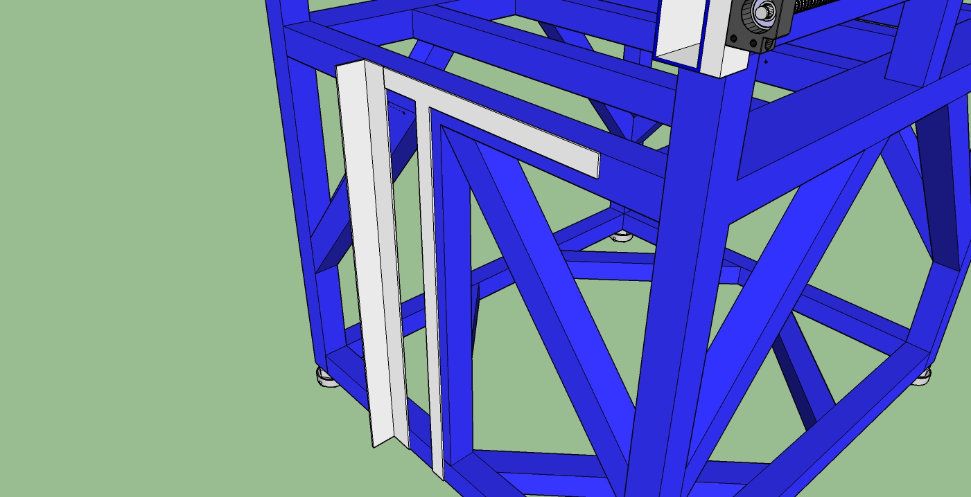

    Frame made of 50 x 50mm and 50 x 100 (3mm) steel profiles. I intend to use the epoxy self-levelling support technique (30 – 40mm wide channels, 5mm thick).
    Gantry made of aluminium profile.
    Mechanical parts:
    • Ballscrews (C7): RM1610: X-axis: 1015mm x 2, Y-axis: 800mm x 1, RM1605: Z-axis: 340mm x 1
    • Ballscrew supports: BK12 (fixed end) x 4, BF12 (loose end) x 4
    • Ballnut housing: 1610 x 3, 1605 x 1
    • Linear rails: Hiwin profile 20mm, HGH-CA (HA, CW)), standard preload Z0. X-axis: 1000mm x 2, Y-axis: 750mm x 2, Z-axis: 416mm x 2
    • Pulleys: 20T, 21,8mm Dia., 8mm hole x 8
    • Belts: 15mm HTD, 1:1, (20T : 20T).
    Electrical parts:
    • Stepper motors: Nema 23 - SY60STH86-300BBF, x 4 (parallel connection)
    • Stepper drivers; Leadshine EM806, EM860 or AM882 x 4
    • PSU Linear, 70V, 9A. 500W toroidal transformer (rectifier, capacitors, softstart)
    • Controller Smoothstepper, or Pokeys57E
    • BOB Machschmidt BOB v1.5, OPPBV3 (DIY CNC) both require separate spindle control board (e.g. SP5 V5 Spindle Board from DIY CNC). Alternatively Chinese board with built in spindle control: http://www.ebay.com/itm/6-Axis-CNC-M...item1c3dfdfbde
    • Spindle motor: 2.2KW with VFD and water cooling.
    Software;
    • Control SW: Mach3 or 4.

    Nils,
    Wow what a start! I think this introduction has first place position as the best example of a new comer, doing their much needed research first and then presenting to us a damn fine example of what is here on the forum learn from, be inspired from and then made into a reality.
    I think if you build this machine to what is suggested in the CAD models and it finishes mechanically sound with an Electrical setup to the same standard, you'll finish with a flawless very capable machine.
    The ONLY thing I think you should consider and do, is to move the Y Axis (Longest Axis, the bed) motors to outside the machine frame, I think their current location could give you a risk you don't need to take, first they could get in the way of the Z Axis accidently causing unnecessary damage, they may also be in your way if you decide to start using a coolant system as they could get wet and soiled and for woodworking, they could end up covered in dust, motors get very hot, internals could become clogged up/dirty.
    Other than that I think you have a winner - GET CRACKING !
    Agree with Lee - nice design. Will do just want you want it to !
    Some other minor things to think about:
    Z travel is quite long - I guess you need that much to do the speaker cabinets if they are partially assembled? If you want to cut aluminium then you will probably need to raise the job towards the cutter to limit the reach of the tool and keep the stiffness up. Some thick packer plates or wooden blocks should do it but you can add those when you are ready.
    At the bottom of the frame I'm not sure I'd do the diamond in the base legs, may be just a diagonal across from one corner to the other, and I'd probably add adjustable feet to level it.
    That's it really . . .
    looks good
    i think you might struggle with alignment with the y rails running top and bottom , maybe placing on the front face will be easier .... my first machine was like that ... just a thought :D
    blackrat - sorry for mixing up the X and Y axes. I expect that you mean the X axis according to my new drawing? Maybe it is better, but it will also reduce the effective Y-axis work length. Anyone to comment on this?
    JAZZCNC - with respect to extending the top rails (Y-axis), I am not quite sure what you mean by "placing gantry in space using a short cantilever"?[*]With respect to BOB - I have noticed that you are not happy with cheap Chinese boards - and very understandable so, if you have had bad experience with them. My reasoning was that the signal "processing" (Smoothstepper) is the critical part and that the BOB is really a fairly simple device which is not so likely to fail or give problems. A concern with the PMDX 126 (which is undoubtedly very good quality) is that it does not have controller for spindle and pump.
    100% agree with Lee (No I'm not sucking up so you lot can shut up before you say it.!! ) Let this be a lesson to others on how to go about starting a CNC build.! . . . Well done Sir A-Star +.!
    I do have some suggestions for you thou. Other than turning the motors outward which is a must do.!
    Put some ends on the gantry it will greatly stiffen it up. I would also think about lowering the ballscrews has they are vunerable up there and some form of protection from chips etc.
    This can be achieved by making the gantry narrower so it's just extends past the sides of the machine. The gantry ends then extend down past the top rail 3-5mm away from the steel and on the inside of the ballscrew. The gantry sides can then be bolt to the gantry and the bearing plates making gantry slightly narrower and a very strong structure.
    This then allows you to place the ballscrews lower down out the firing line of chips protected by the top rail and damage from dropped materail etc.
    The gantry side being on the inside of the screw makes alignment and setup of the ballscrew much easier. More importantly it narrows the restriction from the moving part the gantry and allows you to cover the screws easier with covers for protection. If your not sure what I mean ask and I can provide examples.
    Also think about extending the top rails past the ends of the machine.? If done at both ends this can gain you back some cutting area and full access to work area by placing gantry in space using a short cantilever and at other end allow gantry to pass the front of machine so materail to be clamped on the end and edge machined or over height material.
    I suggested this to Eddy at time he was designing and he didn't take up on it to only later end up cutting lumps out of his bed so could edge machine material ie: dove tails etc.
    Only other change to frame I would make is to remove the back plate on the axis which moves acreoss the gantry. It's not required, it adds weight and very little strength. Can make the building much harder has the mating edges need to be perfectly 90deg otherwise it can twist and bend the bearing plates. Profiled linear bearings don't tolerate this very well and will bind.
    Nice strong Drop down bracket will work just has well be much lighter, cheaper and easier to build.
    Electrics then the only thing I would change is the BOB. For get the cheap chinese stuff you'll only regret it. I wouldn't use DIYCNC stuff either if your going with Smooth stepper. Honestly there really is only one BOB worth using with the ESS and that is PMDX 126.
    All the others will at some time give you trouble or restrict the machine performance. Pay the extra at the begining and you won't regret I promise you that, which can't be said for the others. Trust me on this I've used most if not all of them.
    What I've suggested are just that suggestions and what you have drawn so far would work great but some of those things I've suggested I think you'd find would probably be on your bucket list for Mk2.!!
    Well done and if you build with the same careful attention then you'll have nice machine.

    Quote Originally Posted by ngundtoft View Post
    There is no right or wrong it's how you view the machine. From the front it makes more sense to call long axis Y.
    Argh but your assumption that the BOB is fairly simple device is mistake often made. BOB is actually the single largest cause of trouble and strange happenings with CNC machines.! Cutting corners here is recipe for trouble believe me.
    The thing you have to realise is that the BOB handles all the signals and if it's low quality with slow opto's or poor circuitry then those signals get strangled, distrorted and weakened. There's no point having an external motion card which gives nice fast crisp pulses if the BOB is going to bottleneck them and distort the signals.
    Like anything in life the CNC machine is only good has the weakest link and cheap BOB will be just that then some.!!

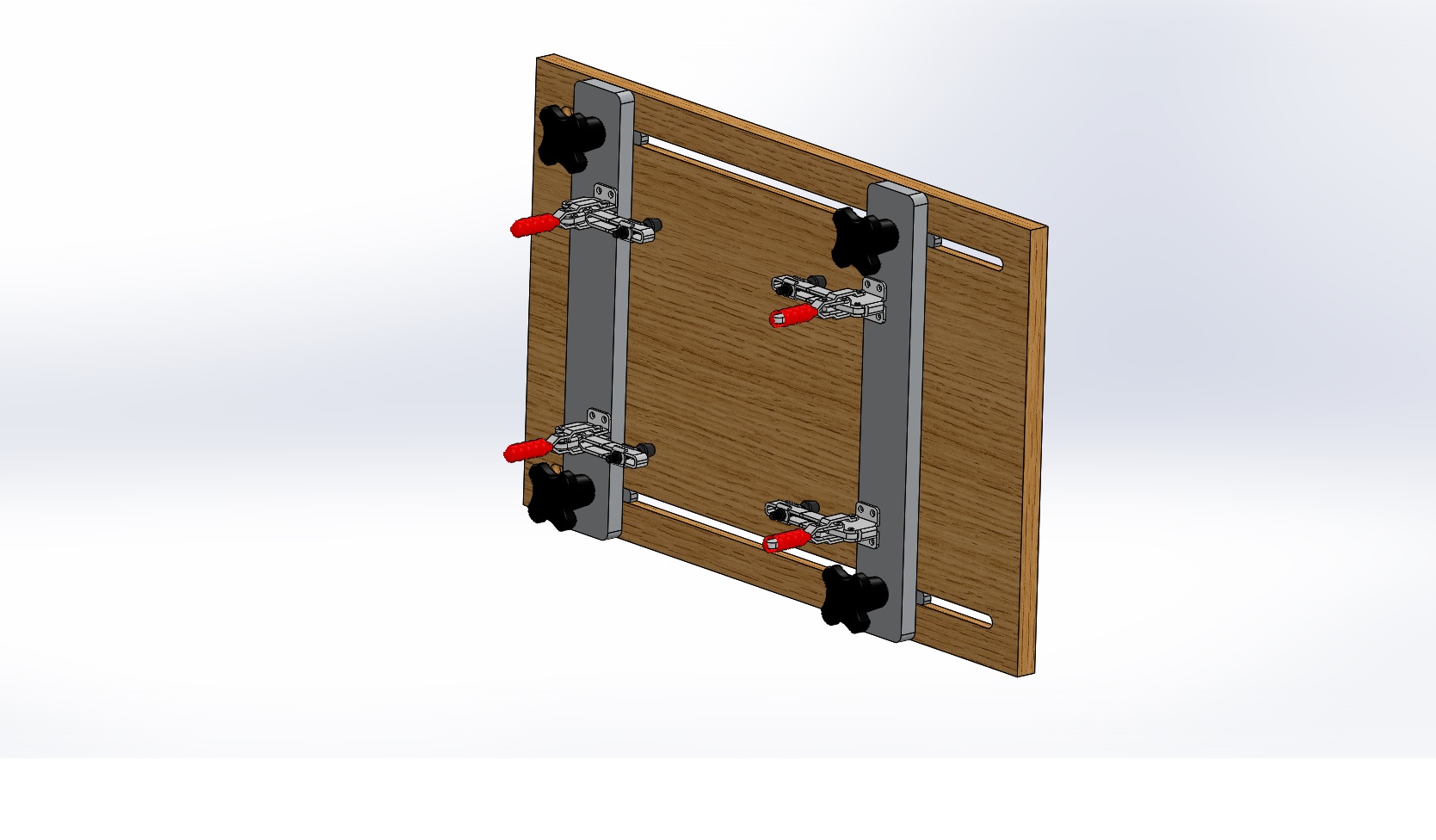

    Can you please tell me what these profiles are called and where you can buy them. It looks like they are approx. 100mm high in the first of your pictures. I have searched the net, but I have not found the same profiles.
    One more question - what distance approximately should you aim for between the tip of the spindle and the bed (steel frame), in the down position?
Name:	Axis orientation.jpg
    I remember Jazz showing (it had a red frame I think) a design that did just this, it could take panels etc on the front to rout the ends. This is one thing that I'd on my list for mk2.......
